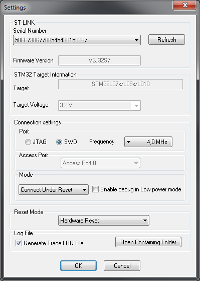

I use SWD interface to configure my STM32 board.
It all worked out, but I changed #define and moved to a part of the program that disabled the sw interface.
Now my STLINK/V2 can not connect to the device.
Do you have an idea to erase the chip or restore the SWD interface?

Or connect under reset.
4 REPLIES 4
Reset with BOOT0 pulled high, and erase ​
Thank to you too @Community member​  @Uwe Bonnes​
I don't try the first method because i've a 0402 resistance in pull down but it could have been done if necessary.
Just to configure ST-LINK in another way
