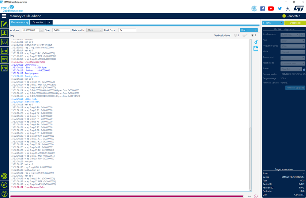

In the last weeks, I was working on running W25Q256 nor flash chip from vendor Winbond with STM32F746 MCU on a custom board. My guideline in this road is ST's how to run QSPI flash video tutorial (5-part video) and of course some genius guys in the community who's helped me a lot to rewrite the functions of QSPI flash (Init, Erase, Write, Memory-mapped). So far functions tested in the Main.c and I can read the pre-written data on the memory. The next step is to generate (.stldr) external loader file and modify Flash.ld file.
according to the video tutorial, I added Loader_Src.c, dev_inf.c, and dev_inf.h files to the workspace but there is a little confusion about flash.ld file that contains memory definitions and all other data and text stuff to assign to specific memory (>FLASH, >RAM, >QUADSPI).
for the point of concern, I use STM32F746 with IS42S32400F SD-RAM connected with 2-banks to MCU and of-course W25Q256 NOR-FLASH.
- how to modify flash.ld file to my specific condition and generate .stldr file using loader files added?
- I generated an external loader file before, but when I added the loader file to the CUBEPROGRAMMER directory, it didn't recognize by the programmer and got an error with blank fields in EL section of the programmer!
here I uploaded relevant files for check

‎2021-01-07 11:56 PM
@Community member​
Dear Clive, would you please make an external loader for me? cause it becomes really really annoying to me:confounded_face:.
My flash chip: W25Q256FV
Pinouts:
PF6 ------> QUADSPI_BK1_IO3
PF7 ------> QUADSPI_BK1_IO2
PF8 ------> QUADSPI_BK1_IO0
PF9 ------> QUADSPI_BK1_IO1
PB2 ------> QUADSPI_CLK
PB6 ------> QUADSPI_BK1_NCS
it would really helps.
Note: this is a commercial project and not a hobby, So I'm running out of time. please let me know if a refund needed;)
‎2021-01-08 7:19 AM
I have a W25Q64/128 one built (3-Byte Addressing), I'll need to finish porting the 256 (4-Byte)
The initial load on the H7 is still broken in Cube Programmer, so a disconnect/connect is required before it runs the STLDR/ELF Init function properly
‎2021-01-08 8:27 AM
This might work...
Still under development
‎2021-01-09 4:15 AM
@Community member​ Unfortunately none of them works. still, has init fail error even when connect/disconnect.
Actually (maybe) it is because of the H7 compatible loader, Mine is F746 instead. As you know, the RAM start address and vector table location are different from H7.
‎2021-01-09 12:17 PM
Ok, sorry, had H7 on the bench, will migrate something to the F7
‎2021-01-09 9:15 PM
‎2021-01-09 10:56 PM
@Community member​ I can't believe it works...Thanks a lot, each and every function are completely OK, saved my life, Clive. ST community is meanless without your efforts man.:baby_angel:
