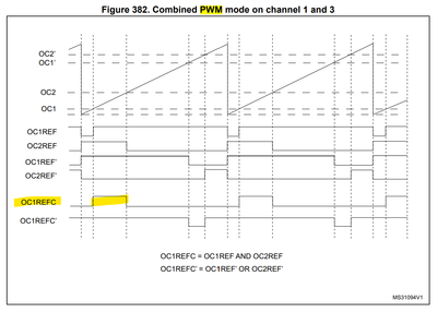

I expected to see a 10 ms pulse, which starts after 30 ms and goes down after 40ms. Why is this not working? I do not get any output when using the combined PWM mode. When just set the normal PWM mode for TIM8 channel2 I see the normal PWM, so the output and stuff is set correctly. It's just the combined mode that is not working.

// Basler: The Basler camera is triggered by a combined PWM mode, to ensure a low level at the end of the frame triggers,
  // while still (almost, at CNT=1) starting high.
  // 12:  Combined PWM mode 1 - OC1REF has the same behavior as in PWM mode 1. OC1REFC is the logical OR  between OC1REF and OC2REF.
  // 13:  Combined PWM mode 2 - OC1REF has the same behavior as in PWM mode 2. OC1REFC is the logical AND between OC1REF and OC2REF.

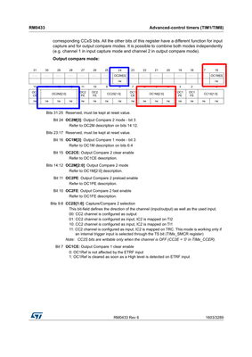

1. 0x12/0x13 != 12/13
2. TIMx_CCMRx.OCxM bits don't form a continuous bitfield (for historical reasons)
