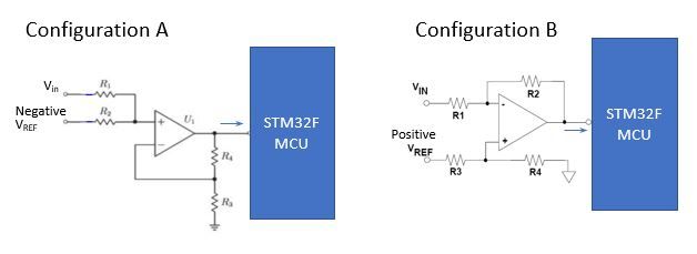

‎2021-11-12 4:47 AM
Do you mean that I have to use an OP-AMP Circuit as shown below?
Please let me know.
‎2021-11-12 5:17 AM
Yes, except in the first schematics the divider should IMO go to positive VREF.

Alternatively, depending on the signal properties, an AC coupling with serial cap followed by mid voltage could be an option.
‎2021-11-13 10:53 AM
For better quality, consider using an OPAMP. It will allow you to ​add Vref/2 offset (mandatory), make low pass filter (to avoid aliasing) and drive with low impedance the ADC input. Otherwise, as stated by Jan, it will be difficult to keep a short sampling time vs relative low impedance of mux/sample and hold of STM.
