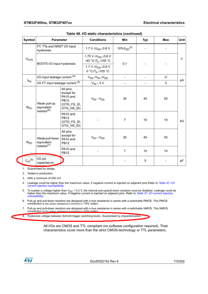

While the footnote number is given to the parasitic capacitance value, the footnote talks about hysteresis:

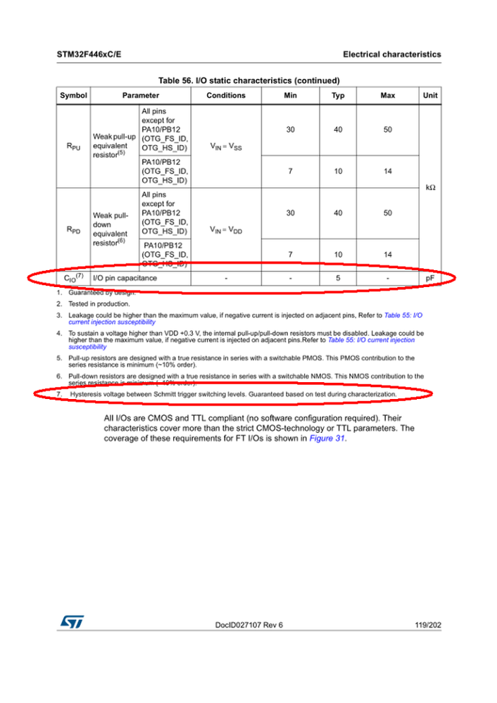

seen in other DS too:

Thanks for highlighting this issue .It is noted and will be fixed soon.
