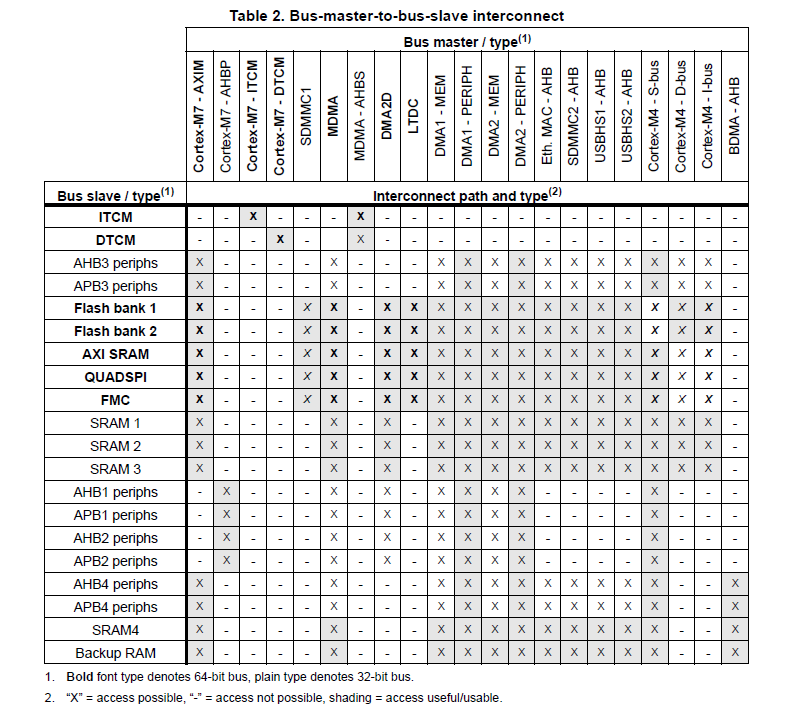

I want share FMC(interface SDRAM) core between CM4 and CM7 core on STM32H7.
I config by cubeMx, CM7 can access ok but CM4 can not access.
How to access FMC core by CM4 and CM7?

Hi, I use STM32H745XIH6
  • In cubeMx config, I check 2 cpus can access this SDRAM, the CM7 init FMC
    • CM7 access the SDRAM ok, but can not access by CM4
  • when check 2 cpu can access this SDRAM, the CM4 init FMC
    • 2 cpu can not access SDRAM
I check datasheet of MCU, the FMC 2 cpu can access.
Thanks,
in case 2 : "when check 2 cpu can access this SDRAM, the CM4 init FMC"
Can CPU1 access the SDRAM? (just to confirm that it was correctly initialized)
Br,
Abdelhamid.
