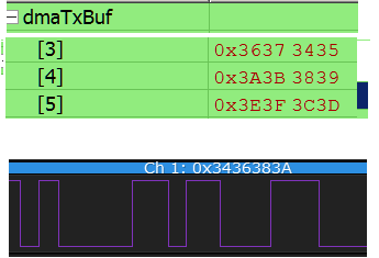

I use it with slave I2S, so error is expected. Works great before the error, but after error got this in DMA TX buffer:
but as you can see it consistently drops every 8bit, that's why I think some offset got stuck internally.
Which I cannot reset easily.

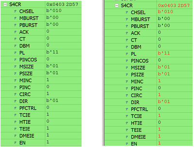

This is my TX DMA stream before error, and after error+reinit, they are the same so DMA should behave the same way
Sure brute forcing brings it back to life, but it takes ton of time to reinit:
