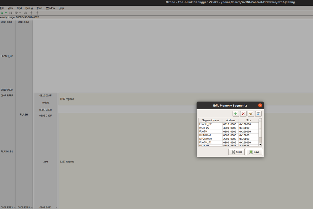

This is what I've setup in Ozone too (using in conjuncture with Seggers J-Link, adding FLASH Bank1 and 2 for good measurement):

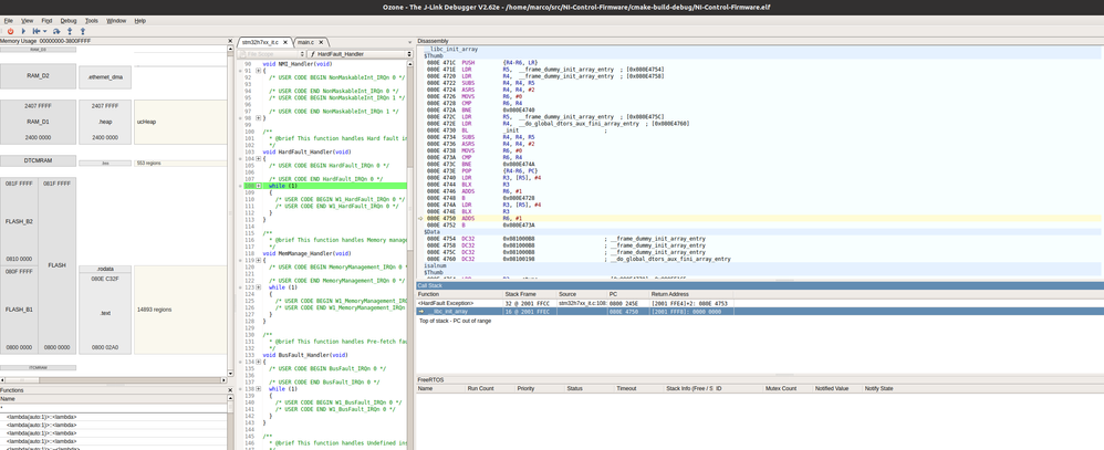

0693W00000D1TNIQA3.pngRunning this code leads to the following:
0693W00000D1TNwQAN.pngThis is clearly not from a bug in our code, but a problem that rose (as this is not a problem with the F767, more about that a bit later).

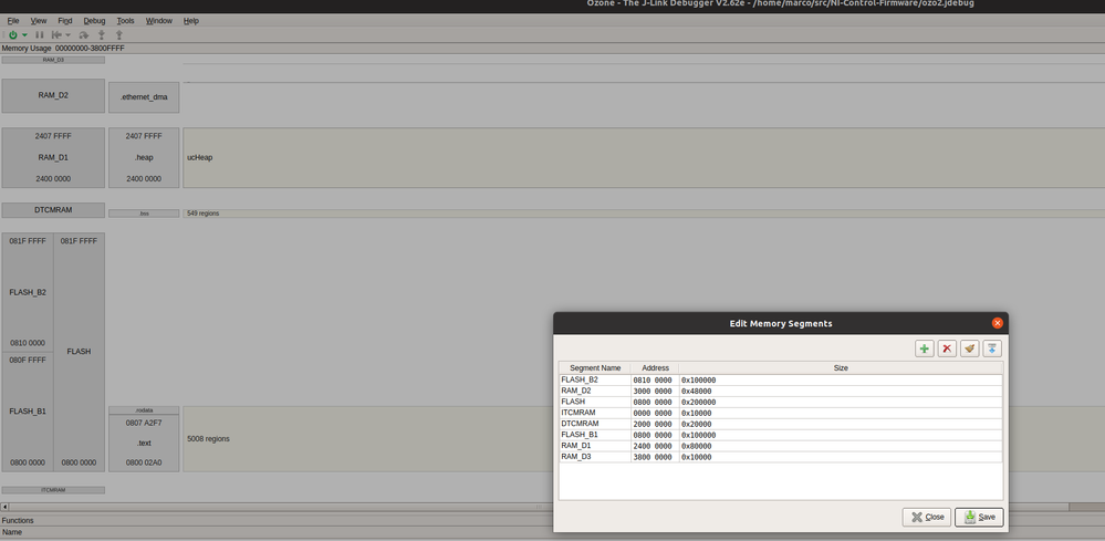

Now, I change 1 thing, not in code, but in compiling: I will add O1 for code optimizations. The above is done with O0 (no optimizations at all).
Then the result is like this:
0693W00000D1TPsQAN.pngand now, when I start the code, it works perfectly fine!
