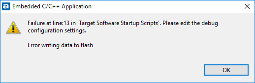

I'm trying to debug a project in TrueStudio, but get this error message during flashing:
... which is the ''load'' instruction of the startup script.
I think the cause of this error is, that the flash size of my program can't be divided by 4 without remainder:
Print size information
text          data    bss       dec          hex
132474    640    38232    171346    29d52
If I modify the project by inserting a while(1) before the use of the library, which makes the flash size not a multiple of 4 bytes, it can be flashed.
Console output:
Flash write: Address= 0x800d0a8, Length=70
Programming flash..
STM32 device: flash programming successful 0x800d0a8
Flash write completed in 0.085000 seconds, 0.804228kB/s
Flash write: Address= 0x800d0ee, Length=126
Programming flash..
Flash programming alignment error
I ported this project from an F3 MCU to the L4 MCU. The F3 project could be flashed by TrueStudio without any problem and had a flash size which was not a multiple of 4 bytes, too.
I can program the hex-file with ST-Link-Utility and debug with TrueStudio by removing the load-instruction from the startup file, but of course that's not convenient.

I had the same problem.
Update to the new Atollic version 9.1.0. This solved the question to me.
