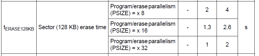

I want to erase flash memory in STM32F207 by sector.
But the Erase time is 1sec typically like following table(datasheet).
(3.3V VPP, 120MHz)
I want to reduce the erase time into about 100ms ~ 300ms.
How can I do it?..
Thanks.

    How can I do it?..
    Bend time and space?
    Journal writes so you don't do continuous erase/write sequences.

    Hello!!
    The flash erase time may be about below 100ms on the code of My predecessor.
    But the erase time of my code is over 2sec like the above table.
    I think that there may be any setting to reduce the erase time.
    My predecessor and I use the same code to erase the flash like below.

    How can I reduce the erase time?
    Is there any setting to do that?

    What can you change in your system? Can you increase VPP?
    The Data Sheet is based on the physics at work, you really can't wave a magic wand and change that.
    We put our configuration data in the 16KB sectors, because they are quicker. Any reason you've picked the biggest and slowest ones?
