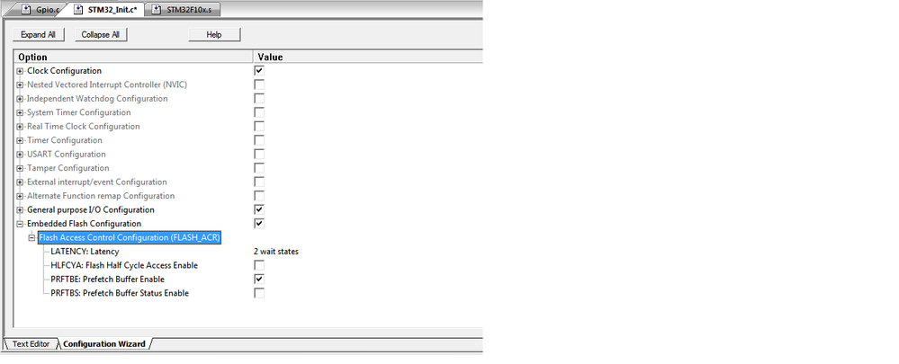

So i took the Stm32 gpio.zip project and changed the configuration to the bank i wanted to use and changed the main to a very simple bit switch. can someone tell me why it wont work?

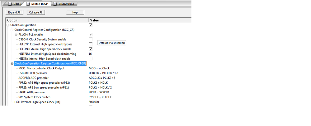

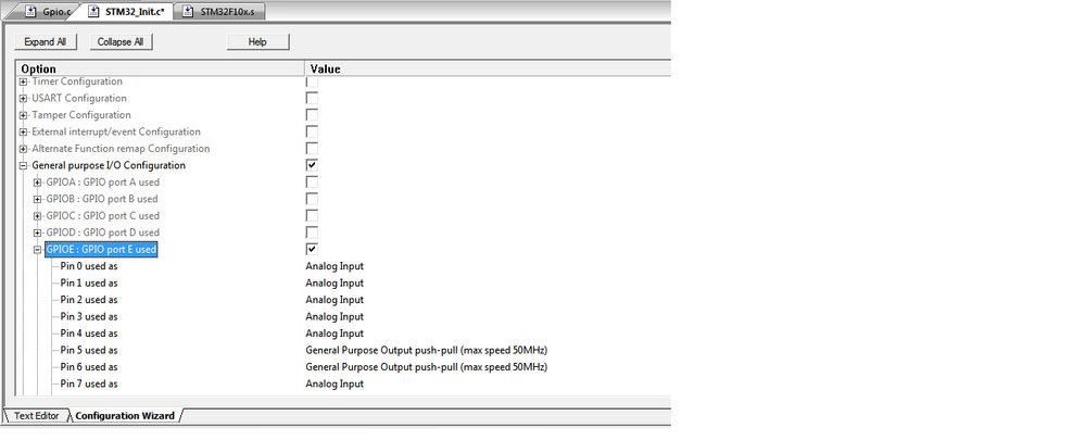

i used the keil configuration wizard. i set the gpioe to pin5 out put. 0690X00000604yoQAA.png 0690X00000604ysQAA.png 0690X00000604yxQAA.png
Posted on August 30, 2011 at 13:22
So you're pretty much reliant on the code generator/wizard to produce the correct code. What part/board are you using? When you debug or single step the code can you see it altering peripheral registers?

I am puzzled by the wizard screens. None of the GPIOE pins can function as analog inputs. Does the wizard assume the user knows best ?
If the wizard can produce a C code listing, look at that and, if you can't spot the error, post it for review.
