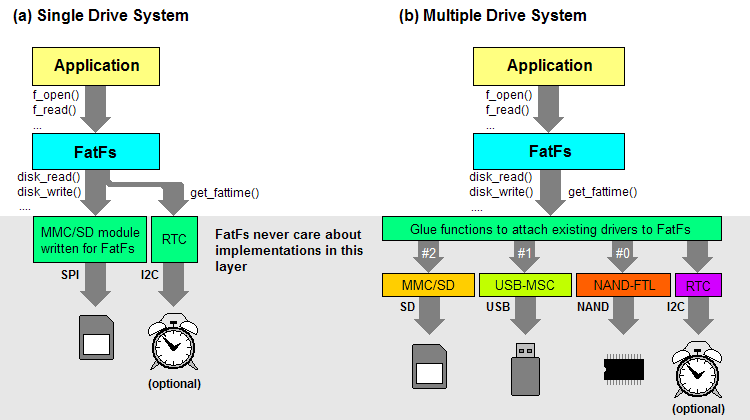

hi, i have the HAL driver for sd card and fatfs software module but i can't understand the mechanisms that both hal and fatfs api's, it's all confused me. stuck here unable to move forward.

Take a look at the Fatfs application note: http://www.elm-chan.org/fsw/ff/doc/appnote.html
The Fatfs api provides you with the hight level functionality of the fat system- it doesnt care to what it is writing or reading. HAL API provides you with the low level api, allowing you to write/read data from the SD card controller.
Fatfs has an interface that has to be "married" with the HAL interface. The mechanism you are talking about connects the SD card access functions with the Fatfs module (by providing function pointers to disk_read, disk_write etc).

To add to Lukasz's comment:
The HAL code is used by the higher-level FAT-FS code to physically access the device.
As user, you only need the FAT-FS API functions, and don't need the respective HAL code directly.
