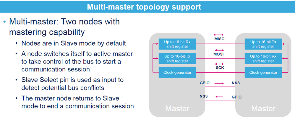

It's also something that I looked into. Due to the SMI line one needs to use a PHY or a FPGA . Another issue for me is that the ethernet connections maximum baud rate is 100Mbit/s or about 12 MBytes/s without substracting overhead.
The SPI connection with 54MHz theoretical speed in master -master seems more straitforward to implement and could, if agregated, offer baudrates of up to 6.75 *2 MBytes/s without requiring external components or without too much indepth knowledge of the interface.https://st-onlinetraining.s3.amazonaws.com/STM32F7-Peripheral_Serial_Peripheral_interface/index.html
2017-08-02 7:41 AM
I agree as I think this is still the best method because it demands the least rework of libraries. I will go for this solution and tell you how it goes.
