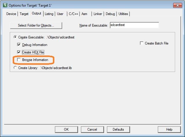

Hi, i'm facing the difficulty of compiling the HAL driver codes takes nearly a 1:30 -3:00 min. So what should i do now?:sad_but_relieved_face:. it is quite a long compilation time for my application.

In Keil uncheck options to generate Browse Information

Keil has some egregious issues with the browse information (at least in the 5.x compilers) where a rebuild of a HAL example might take several minutes, and perhaps 10x or 20x slower than necessary.
