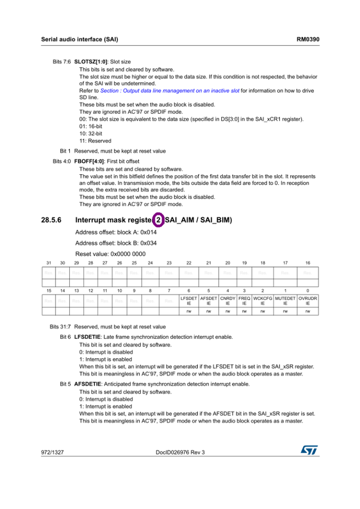

['F446 documentation] Probably typo in chapter name
waclawek.jan
Posted on January 03, 2018 at 17:07
Is it a typo or is there some Interrupt mask register 1?

Imen.D
Posted on April 06, 2018 at 17:06
Hello
Waclawek.Jan
We confirm this is a typo and will be corrected in coming release.

Hi @waclawek.jan ,
I closed this post as this error was fixed in Revision 5 of RM0390.
Thank you for your contribution.
