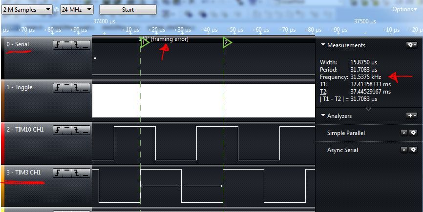

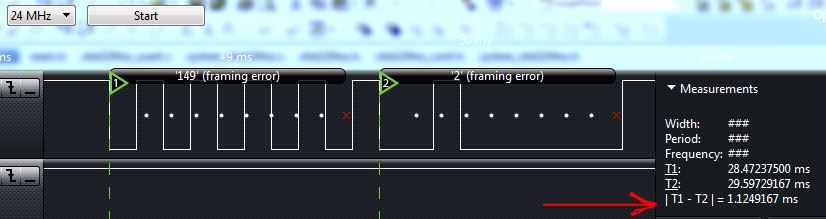

And the picture shows the USART1 TX output at 9600 baud setting in STM32

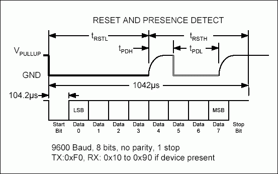

I added a timing reference picture for 9600 Baud, and here we can see that i hole frame should be 1024uS

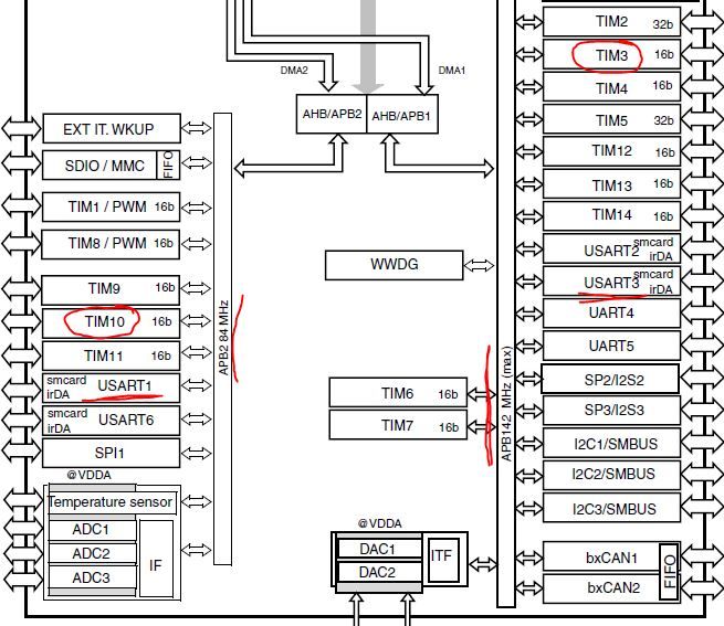

I know that it has to do with the clock settings, so i put together a example with Timer3(APB1) and Timer10(APB2).
I made it so both should output PWM on one pin each so i could check so both APB1 and APB2 is running as thy should.
because USART1 is on the APB2 bus and USART3 is on APB1.
Both Tim3 and Tim10 is set to 530 KHz

here we can see that TIM3 CH1 is the selected one, and the Frequency show 5375KHz.
And TIM10 CH1 is a bit of in phase, but we can see it has the same timing and frequency as TIM3 .
So the APB1 and APB2 seams to be running at the right frequency.
but i still get 1124uS frame timing for USART1 and 3255uSframe timing on USART3 when thy are set to 9600baud

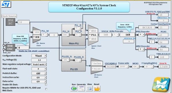

my settings from the clock configuration that i am using

uint32_t T1 = HSE_VALUE;
uint32_t T2 = HSI_VALUE;
uint8_t dummy = 0;
RCC_ClocksTypeDef RCC_ClocksStatus;
/* Configure the USART Baud Rate */
RCC_GetClocksFreq(&RCC_ClocksStatus);
dummy = 1; <- I put the first breakpoint here
/* System Clocks Configuration **********************************************/
SystemInit();
dummy = 2; <- I put the second breakpoint here
and i got
At first breakpoint (all in decimal)
At second breakpoint (all in decimal)
Thats weird, you can se that HSI_VALUE (T1) = 8MHz
but i don't think the clock is running at 525MHz :)
i tested to change the HSI_VALUE to 1MHz
result
you can see that T1 = 1MHz, and the clockstatus has not changed at all
so i debugged the function
and got
I debugged the code line by line and got (HSI_VALUE@8MHz)
/* Get SYSCLK source -------------------------------------------------------*/
tmp = RCC->CFGR & RCC_CFGR_SWS;
= 8
pllsource = (RCC->PLLCFGR & RCC_PLLCFGR_PLLSRC) >> 22;
=1
pllm = RCC->PLLCFGR & RCC_PLLCFGR_PLLM;
=8
i change this part of the code (added a temp) so i could see the register data
if (pllsource != 0)
/* HSE used as PLL clock source */
temp = ((RCC->PLLCFGR & RCC_PLLCFGR_PLLN) >> 6);
pllvco = (HSE_VALUE / pllm) * temp;
temp is set to 336
pllvco 1050000000 <- this is strange, becuse pllm = 8, temp=336
then if i calculate the HSE_VALUE from this a get 25MHz, hug ???
hmm oki
I did not think this was possible, but while i debug check the HSE_VALUE in main.c
and it says 8MHz
and when it gos into the RCC_GetClocksFreq function in stm32f4xx_rcc.c
i check the HSE_VALUE again, and now it says 25MHz
the stm32f4xx.h is the only place a define the HSE_VALUE = 8MHz
and i can not find any other defines in my code

lizerd
Posted on August 13, 2013 at 08:55
Yeeh i found the problem,
I'am using Rowlys Crossworks as IDE. And it has it's own stm32f4xx.h file that is used instead of the one that i point to, but only for some files.
The question is, WHY do not the compiler complain when the it find a new HSE_VALUE definition.
hmm but now it works, anyhow yeeeh
if anyone wounder where the files are..
C:\Users\username\AppData\Local\Rowley Associates Limited\CrossWorks for ARM\packages\targets\STM32\include
