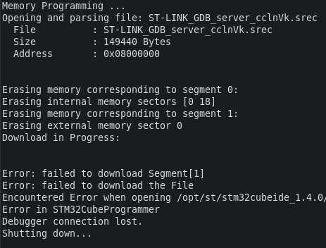

Application is generated using the CubeMX with TouchGFX generator. Works wonderfully... that is until I want to locate my assets in OSPI.
Added this to the STM32H7B3LIHZQ_FLASH.ld file

0693W000006F4FOQA0.pngSelected correct external loader file.
And get a nice long timeout with this result:
I've tried just about everything I can think of for the past 3 days. I'm missing some concept on how the external loader works or ... something.
