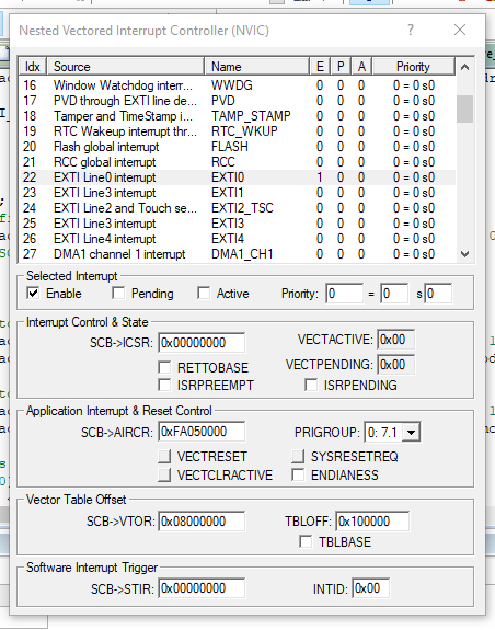

Hi, I'm trying to execute an interrupt with the pin PCO with stm32f303re Nucleo board, but the interrupt routine never executes, actually, it just stops the program. this is my configuration code for the interrupt:

}and in the debug view i can see that the processor triggers the interrupt, but it just stuck the program and the interrupt is never executed:
before pressing the button connected to PC0:
after pressing the button:
Thanks for any help.
2021-05-08 1:31 PM
If you stop execution in debugger, what do you see, where is the PC, how does the ISR look like?

2021-05-08 2:20 PM
Honestly, this is what i have seen, the compiler does not create asm code for the ISR, i don't know why, so i can't see it in disassembly view. I don't know if this helps
2021-05-08 3:08 PM
That's problem.
What toolchain are you using?
Consult the toolchain's manual for proper way to use ISRs, study available examples. Some toolchains require a special way to tag ISRs, to prevent them being optimized out.
Check if the ISR's name matches that in the vector table (case sensiive), which is usualy located in the startup file.
