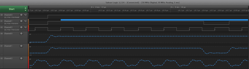

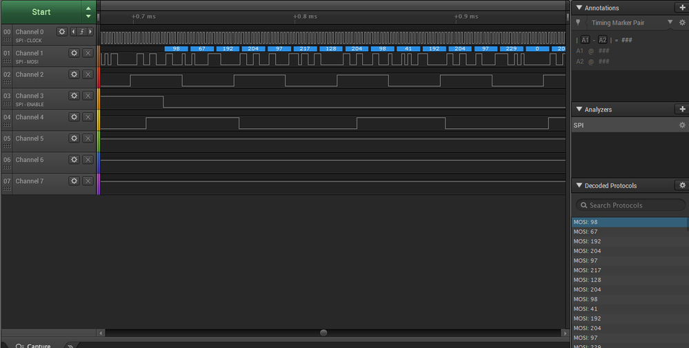

I connected the TI device ADS127l01 to the STM32F7. The output of the ADC is configured in Master mode frame sync with MCLK=4MHz, fdata=15kHz, sclk=500kHz. The ADC output signal is a bit like a ''1channel 32Bit I2S''-data, with sync on 15th bit.
The NSS is just toggeld for debug. This is to see the data in the logic analyzer starting on a user button. Below is the SPI data measured with a logic analyzer ( Channel 0 = sclk, 1 = MOSI, 2=Frame sync, 3 = NSS, 4 = debog out).
The channel 4 debug out is an GPIO output toggled, always when the frame sync Interrupt handler void EXTI2_IRQHandler(void){} is entered.
This is not synced to the frame rising edge. Maybe this is part of the problem. Again it is a DC voltage at the input of the ADC, which should give { 255, 255, 255, xxx}.
Is it the right way to sync on the frame signal with an GPIO-interrupt?
Kind regards
Posted on January 08, 2018 at 19:58
Please describe the channels in terms of the ADC pin names (where applicable).

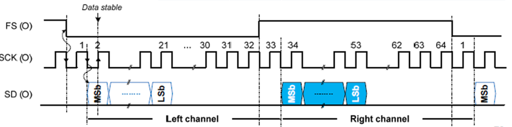

Looking at Fig.3 in ADC's DS, you want to start SPI on the rising edge of FSYNC, within less than half a SCK time, which is 1us at 500kHz. If ch4 is generated from ch2 by togging a pin in EXTI interrupt, on a F7, lagging some 10us and jittering several us, you are clearly far from that goal. Even if you get rid of the HAL fluff, switch on optimization and run it on the 'F7 raging at hundreds of MHz, if there are other tasks which may interfere, it would be a risk to do this start in software. You may start later, but the delay must be consistent, jitter significantly below SCK period. That calls for hardware to accomplish this.
As SPI can't start on external stimulus natively, AFAIK, you can either devise a timer_capture-triggered-DMA loading SPI's control register to do the start, or - as you've remarked - try to use the SPI in I2S mode (that assumes to have the frame signal connected to WS pin).
The displayed waveform is clearly far from any resemblance of xxFFFFFF, so you probably have some work around the ADC to do, too.

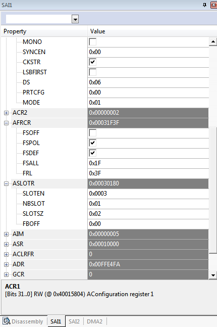

The hardware configuration of the ADS127L01 is in Frame sync slave mode. I daisy-chained two ADCs, which gives an interface quite close to an I2S-Interface with 24Bit data size.
The STM32F7 is connected with its SAI in Master mode delivering the Bitclock and LRclock(Frame sync) to the ADC. The Masterclock (MCLK) is generated by a 12.288MHz crystal oscillator and connected to the ADC and the STM32F7 RCC audio clock input. The SAI clock selection is set to the RCC_SAIxCLKSOURCE_PIN. Important here was, that I had to generate the MCLK also by the STM32F7, even I DO NOT use it further. This is necessary to be able to set the Bitclock different from the MCLK.
The LRclock is 48kHz and the Bitclock of 6.1MHz is set with a frame length of frl=63.
Here is an example of an I2S connection with a data size of 20Bit:
The interface of the ADC ? ADS127L01 is a bit different:
            FSOffset: LeftJustified, the data is clocked out with frame sync
            Clock strobing: Rising edge of Bitclock is synced to frame
            FSPolarity: Active high
With this settings finally the configuration was fine and the ADC is doing a wonderful job.
The following  shows my register settings of the SAI and the measurement of the communication with a logic analyzer.
