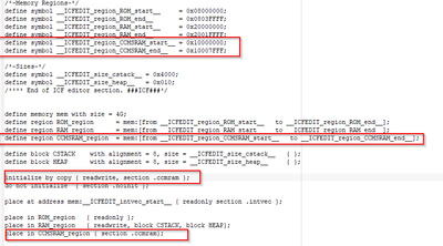

I wanted to put some complicated calculation into CCM SRAM in my STM32G474RE MCU. I basically followed instructions of AN4296, unfortunately I found an issue when programming the MCU.
A few attaches as below:
1. The link script
2. The code change
3. The error reported
The updated code can compile and link successfully, but I just report an error when click "Download and Debug" button
4. The map file
As the map file indicated, the link successfully put the function into CCM SRAM.
Any help would be greatly appreciated.
Thanks

From the error message it looks like the IAR debugger tries to "flash" the stuff in the .ccmram section. Of course this won't work. Data and code in internal RAMs should be placed in the flash image and initialized by the app startup by copying from the flash image.
Your link script contains "initialize by copy {readwrite, section .cmram}" - but this does not have the desired effect. Check the IAR fine manual for correct syntax?

The icf file in that example looks same as in the OP (what concerns the ccmram)
Indeed, it works as mentioned in the application note. .ccmram section should be initialized by copy at startup since the code is located in an internal CCM SRAM.
