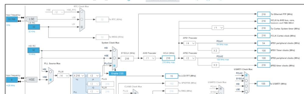

  • MCU: STM32F767IIT
  • IDE/Debugger: STM32CubeIDE / SEGGER J-Link​
  • When HAL_PWREx_EnableOverDrive() is executed after changing the block size of SPI Flash, the following error occurs: Break at address "0x64da2200" with no debug information available, or outside of program code
  • Even if the settings are reset to the original, recovery is not possible.
  • The program operates normally only when the overdrive function is not executed.
