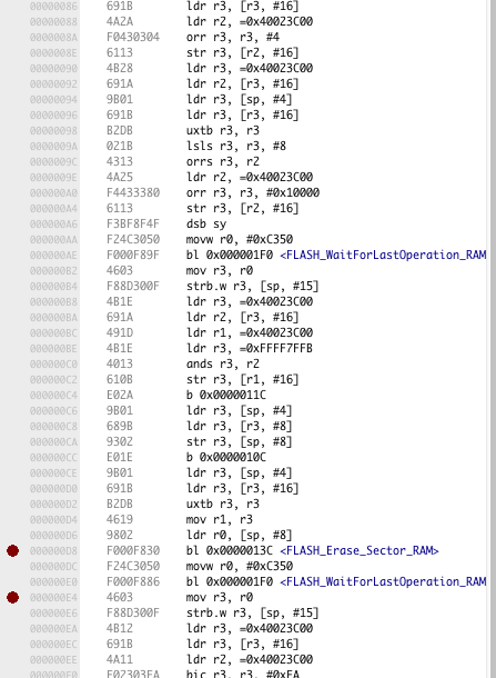

I am trying to use FLASH to emulate EEPROM on stm32F767 based on AN3969. My FLASH is organised as a single bank, so executing from FLASH I would expect execution to stall while writing / erasing. The longest stall is when erasing a sector, which might take 0.5 s for a 32k sector at PSIZE=32 according to the data sheet.
However, with APB1 clocking at 36 MHz, I need to service the WWDG at least every 58 ms, so a stall of 0.5 s causes a WWDG reset, which is what I see.
I have tried placing the relevant routines in ITCM RAM but I still get the WWDG reset. I have disabled all interrupts, so my FLASH_WaitForLastOperation() polls the SysTick interrupt to increment its timeout counter. And similarly I tried to feed the WWDG in the event of a pending WWDG interrupt.
Does anyone know of any "gotchas" as to why I am still getting a stall, even though I'm executing from ITCM RAM?

Any read to FLASH during programming will stall the processor. This includes reads of (constant) data - are you sure the routine moved to ITCM RAM does not read constants from FLASH? (hint: examine disassembly or assembler listing; or step through in debugger observing the target addresses from which ldr read).
In F7, I am not sure if the processor+cache may perform significant amount of prefetch, which would run in parallel with execution from ITCM RAM for long enough to cause this sort of problems, but if you find no other culprit, it may be worth to try to go along this path too.

The source-code around the fault (from stm32f7xx_hal_flash_ex.c) is as below. I have added the suffix _RAM to routines that are placed in ITCM RAM:

Single-stepping disassembly is (too small for me to see):
Or as a code-snippet without the addresses

If I execute by single-step the "9802 ldr r0, [sp, #8]" then I get the fault. So by implication we're getting enough speculative-execution of enough of "bl <FLASH_Erase_Sector_RAM>" to start the write. I've specified FLASH_VOLTAGE_RANGE_3 so there's quite a lot of code to execute in:

So I'm not convinced of that amount of prefetch/speculative execution.
