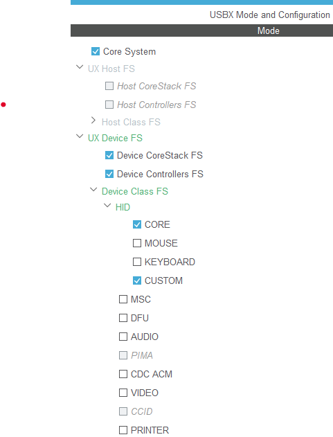

I agree that there is no need for this device to be configured as  a "custom HID" class, (or any other class for that matter), but the selection of a class seemed to be necessary to utilize the USBX middleware.
When I was starting out, I experimented with the mouse HID, and then the customize HID, and just stuck with the later.  I couldn't figure out how to configure my project in STM32CubeMX to be a "Vendor Device" instead of a "Class Device" within USBX.
This is what that configuration looks like:
Do you know how to configure USBX to function as a "Vendor device"?

Try the DFU class.
FBL
Hi @NBC
Unfortunately, there is no direct reference to a vendor-specific device class template within USBX for STM32. I will share your request with our dedicated development team.

You should be fine. The old descriptor(s) can certainly be applied to the STM32C0 series. You just need to make sure you have code for the desired endpoints and EP0 reporting, if any.
Edit: There may be a classic core example that can be applied to the C0 and this would free you from the USBX baggage.
FBL
Hi @NBC
You can use this repository for classic core middleware for C0. Otherwise, I assume this DPUMP class can be useful in your case.
