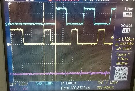

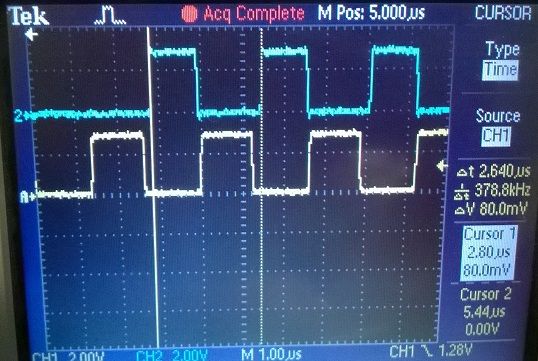

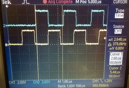

Thank you, Clive for so fast reply. Try to clarify my problem.
It's success situation when IRQHandler execution is less than half of PWM duty cycle. As you see software toggling of GPIO in IRQHandler (blue signal) follows toggling of PWM (yellow line) equidistantly (at the same time interval).
When IRQHandler execution is more than half of PWM duty cycle i saw
desynchronization
 of my software toggling with PWM toggling. I expected saw it in case when IRQHandler execution time is close to PWM duty cycle but not it half.
So what the reason of such behavior? And it's possible to chanhe it?

I understood it but as i said I expected saw that in case when IRQHandler execution time is close to PWM duty cycle but not it half. I have project with clear main loop and one interrupt for timer's update.
I try to change PWMpulse and understood that i was wrong with moment which corresponds to interrupt handler.
So problem is latency between PWM toggling (yellow) and software toggling inside interrupt (blue). What caused so big delay?
