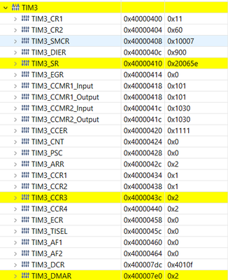

Can you share your timer channel configurations? Register values would be best.
‎2024-07-31 5:52 AM
Below are the register settings as shown in STM32CubeIDE
Also I use DMA to constantly change the value of CCR3 which is what the DMA Burst statement below is for.
The timer starts at 0, when the rising edge is detected the count goes to 1 which matches CCR3 and the output is toggled. Also the DMA is triggered to set CCR3 to 0. Now on the next falling edge the count goes to zero which matches the new value of CCR3 and the output is toggled again and so on.

‎2024-07-31 6:30 AM
Mea Culpa, Mea Maxima Culpa,
I caused noise over some noise but the source of the noise was me.
The channel with the glitch is connected to another timer input through a wire. As it seems now, this wire picked up noise causing the glitch.
Changed the wire, moving it away from other wires and the glitch is gone.
I am very much aware about wiring issues in a proto setup but did not think of this since when the glitch was there, not other signals had an edge that could cause it which is the case most of the time.
Never too old to learn.....
