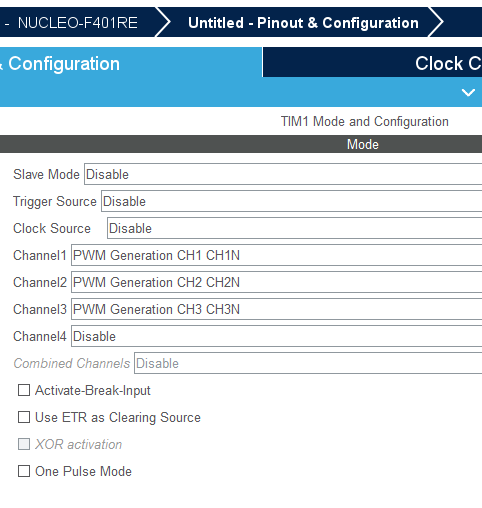

Hi everyone; i followed the tutorial to get two output PWM signal with 10us of death time but i also tried to do a double complementary death time to have 4 signals with rispect death time but it doesn't work. In the main i add two mor command
 HAL_TIM_PWM_Start(&htim1, TIM_CHANNEL_2);
 HAL_TIMEx_PWMN_Start(&htim1, TIM_CHANNEL_2);
 HAL_TIM_PWM_Start(&htim1, TIM_CHANNEL_3);
 HAL_TIMEx_PWMN_Start(&htim1, TIM_CHANNEL_3);
In this way i get two complementary pwm out put signal with death time on channel 2 e 2N but nothing on the other two channel 3 and 3N. This depend of the hardware of my board or i make some error in the setting?

SMusc.1
maybe i found the issue: for channel_3 (also for channel 1) there is no option in Mode to select PWM mode. This mode is only avaiable on channel 2 where the code working

waclawek.jan
Maybe you're just blocking the TIM1_CH1N/TIM1_CH3N pins with some other functionality?
SMusc.1
I forgot to select the PMW Mode for Channel_2 and now is working
SMusc.1
sorry the pulse value
