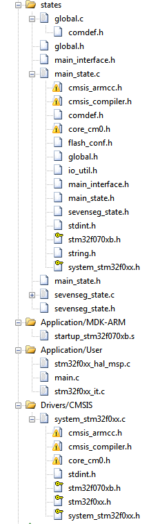

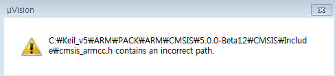

Take a look at my build console output, its a common error I know,
C:\Keil_v5\ARM\PACK\Keil\STM32F0xx_DFP\1.5.0\Device\Include\stm32f070xb.h(130): error: #5: cannot open source input file ''core_cm0.h'': No such file or directory
 If you look the project branch its looks like ARMCC of keil does not support the CMSIS driver!!0690X00000604wNQAQ.png
If you click on the driver file it shows,
Kindly suggest me what to do.

    Posted on November 21, 2016 at 11:33
    I think you haven't configured the Include paths within the project.
    You have to review the defines and provide the compiler with a list of include file paths.

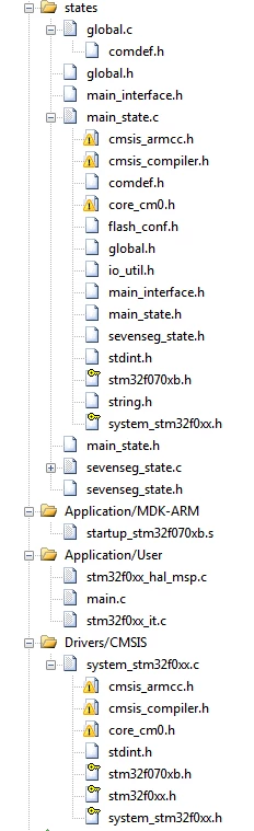

    Dear Sir,
    Thank you very much to text here.
    I have
    selected the device startup in MDK 5., like selecting CMSIS:CORE and Device:Startup .
    And also, after generating a code in cubemx, I have followed the include path same to example project.
    Now it works,
    but build errors exists as I am compiling a complex project.

    Posted on November 22, 2016 at 17:59
    Let me know in which forum is suitable to ask the questions regarding , pre-processor setting, Options for target, macros in this community?
    The audience here is finite. You can also review tool chain documentation, and examples. For staffing, ST maintains a list of consultants and contractors, and has FAE support for large customers.
    The Keil project tree really only wants the .C files dropped into it, it can find the include file dependencies via the Include Paths, and it doesn't need to explicitly compile/build include files, as they shouldn't really be contributing source code to build.
