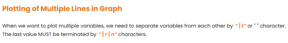

arduino serial plotter has a sintaxis you should meet.
If i were you i would download realterm and check if youre sending the correct " " to separate data or /r/n when serial plotter expects them.
