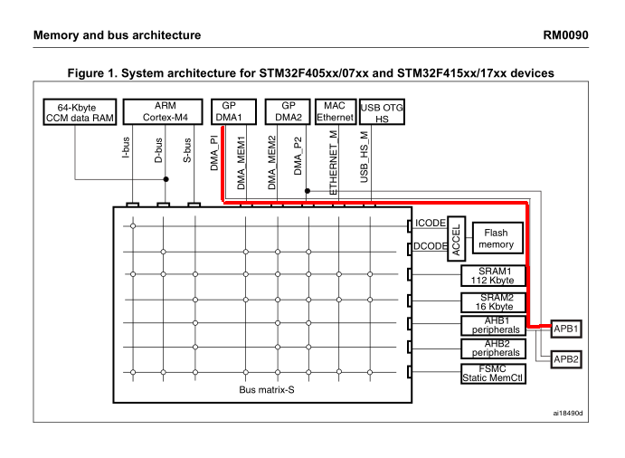

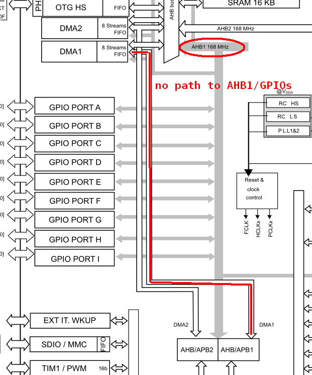

Posted on August 07, 2013 at 19:01
You'll probably want to be using DMA2 to transact with a peripheral on AHB1, which would be classified as a Memory-to-Memory
developer2
Senior
Posted on August 07, 2013 at 19:05
well, i need to use DMA1 for transfer GPIOE to memory,
and DMA2 i will use for different purposes,
is the DMA1 usable for my purpose ? do i have some mistake in initialization ?
Posted on August 07, 2013 at 19:27
DMA1 and DMA2 have multiple streams
To rephrase, DMA1 talks between peripherals on APB1 and memory. It won't talk to peripherals on APB2 or AHB1 (GPIOE)
AHB1, APB2 and Memory are classified as ''memory'', only DMA2 permits memory-to-memory transfers.

Posted on September 19, 2017 at 16:29
This should be in the datasheet and Reference Manual.
Posted on September 19, 2017 at 16:52
Well, it is.
It's repeated as a footnote at the DMA block schematics in the DMA chapter.
That GPIOs are on AHB1 is in Table1.
Both facts can be seen from the block diagram in the DS, too.
Posted on September 19, 2017 at 17:16
A lot of people miss it, you aren't the first, and won't be the last. The RM is the appropriate location, and it is noted several times.
