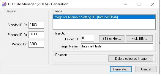

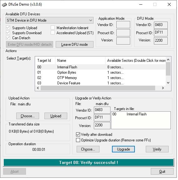

I was trying to flash stm32f722ret6 via DFU mode. DfuSe Demo typing successful status but firmware doesn't update.
0693W00000QNm4kQAD.jpg0693W00000QNm59QAD.jpgBut when I download .hex file via ST-LINK a firmware works. What could be the problem?
11 REPLIES 11
Did it report an error? It's quite an old app, and might have expectation as FLASH and RAM sizing when doing a stack address check.
