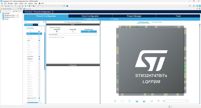

At the moment these are the peripherals I try to enable. Beside this LTDC controller too.
I click each one peripherals and enable with following parameter:
  • MII: Full Duplex Only
  • QUADSPI: Bank1 with single/dual Lines
  • SDMMC1: SD 1 Bit
  • USB_OTG_FS:
Then I see the pins correctly mapped on Microcontroller.

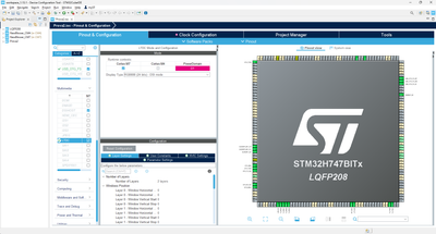

Subsequently I try to enable:
  • LTDC: RGB888 24Bit - DSI Mode
The peripherals is checked green but the pins are not automatically configurated.
Why the application does not default pins mapping?
I have to load each pin one by one?
For now I left without LTDC pins not configurated.

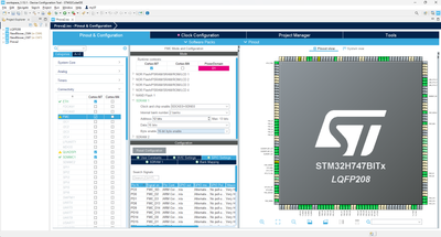

Then I try to configurate the FMC.

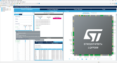

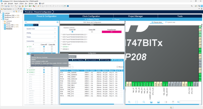

I enable the SDRAM1 with the parameters in picture.

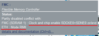

Instantly some peripherals report a warning.
The default pins for FMC are mapped.

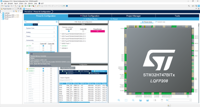

Following the warning I read
At this point I change Ethernet to RMII
The warning disappared but in FMC remain.
Partly disabled conflict with:
what exactly does it mean?
Thanks in advance
Alfredo
Thank your for the sharing.
Is that possible to share your ioc file?
Here it is!
Alfredo

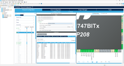

Indeed you have a GPIO conflict on PC5: FMC_SDCKE0 with ETH_RMII_RXD1
and also on PC4FMC_SDNE0 with ETH_RMII_RXD0
So Select SDCKE1+SDNE1 (to use BANK2) instead of SDCKE0+SDNE0 (BANK1)
Using SDCKE0+SDNE0 the port mapping are:
  • FMC_SDCKE0 on Pin PC3C
  • FMC_SDNE0 on Pin PC2C
On this pins there are not Ethernet connections.
In any case using SDCKE1+SDNE1 the port mapping are:
  • FMC_SDCKE1 on Pin PH7
  • FMC_SDNE1 on Pin PH6
The problem remains...
No, The warning is not the same.
In the first warning: it points out a conflict between ETH and SDRAM but in the second one it's showing a conflict between two SDRAM banks which is from point of view not correct. Moreover the second SDRAM is not enabled so no reason to show a warning on something that was disabled.
So you can use Bank2 for SDRAM in your case.
I've already raised the behavior of CubeMx on ticket number 172341.
Ok.
I put SDCKE1+SDNE1.
In any way:
Regards LTDC my previous Questions was:
Thanks
