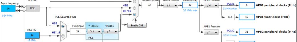

Hi Clive One, for my own exercise, I revisited this thread to play around with the numbers in Cube's Clock Configuration and I couldn't seem to get the 24MHz input crystal to output 19.2MHz or 76.8MHz as you stated here. Can you elaborate on how to get to, say the 19.2MHz from a 24MHz input, as an example? Sorry to bring this up again!

Maybe I am missing something here but not sure if your fitter adheres to the clock tree specified by ST for a particular part, as shown below. How are the pll_m, pll_n, pll_p and pll_comp translating to the PLLMul, PLLDiv, AHB prescaler and APB1 prescaler, etc.?
Posted on July 10, 2017 at 20:21
Look at the RCC tree in RM.
M is the PLL prescaler. N is the multiplier - for some reason ST omitted that from the 'L4 RM picture; look into the same picture e.g. in RM0090. P is the postscaler - in the L4 that particular postscaler is used for a different purpose and R is used instead for SYSCLK output, again look into RM0090 for the 'original'.
pll_comp obviously is the PLL input frequency; you have to check that (and the PLL output freq too) against the PLL range given for particular chip in DS.
