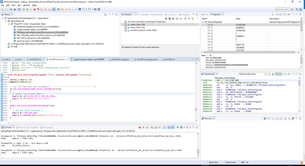

I am having issues when debugging STM32CubeMX for STM32F100RCT MCU generated project in Atollic. The ST-Link debugger jumps to unknown code location and generated HW fault exception. It happens with Cube generated peripheral INI HAL like TIM16, TIM17 and SPI1 as well. Usually in TIMx cases it happens when tmpcr1=TIMx->CR1; line in HAL {void TIM_Base_SetConfig(TIM_TypeDef *TIMx, TIM_Base_InitTypeDef *Structure)} function is executed. In the SPI1 failure case it happens when __HAL_AFIO_REMAP_SPI1_ENABLE() macro is called. I am using Cube App V4.21, FW V.1.4 and Atollic 7.1.2 Lite. Any idea? Please help.

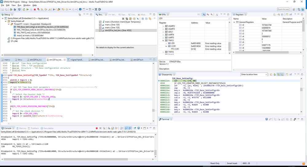

Posted on June 09, 2017 at 08:13
There is still a problem with TIMx
tmpcr1 = TIMx->CR1; line though (see attached screen shots, in this case is TIM15). The peripheral is re-mapped as well, and I saw the same remapping macro calling BIT_SET macro (is this a problem though?).
R0 looks right (TIM15 base address) so I don’t understand what's going on.
Please refer this issue to STM team as well.
Thanks!

I confirm the remap bug for STM32F1 which is planned to be fixed in next release of STM32CubeF1 package.

The issue of getting Hard Fault when executing
TIMx
tmpcr1 = TIMx->CR1; instruction with timers 12...17 was finally resolved. I was using a very old silicon revision of STM32F100RCT6 - rev.X, which does not have all these timers! Unbelievable, because these samples were shipped to me on 19 of May 2017! Apparently ST warehouse in Malaysia dumped me its old stock! Quite disappointing though, a set-back of two weeks in my development!
