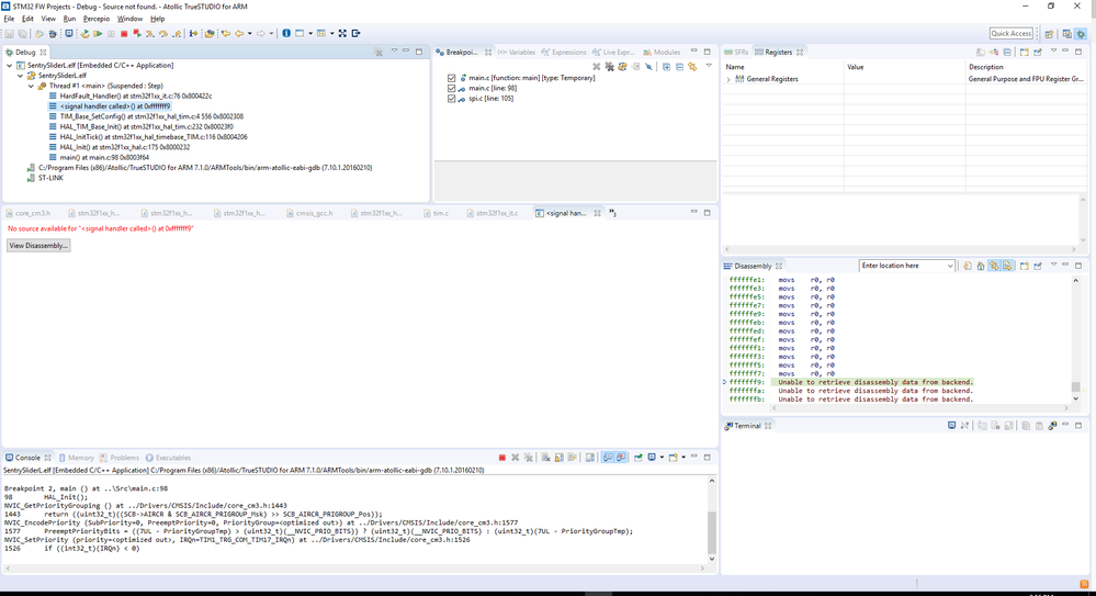

I am having issues when debugging STM32CubeMX for STM32F100RCT MCU generated project in Atollic. The ST-Link debugger jumps to unknown code location and generated HW fault exception. It happens with Cube generated peripheral INI HAL like TIM16, TIM17 and SPI1 as well. Usually in TIMx cases it happens when tmpcr1=TIMx->CR1; line in HAL {void TIM_Base_SetConfig(TIM_TypeDef *TIMx, TIM_Base_InitTypeDef *Structure)} function is executed. In the SPI1 failure case it happens when __HAL_AFIO_REMAP_SPI1_ENABLE() macro is called. I am using Cube App V4.21, FW V.1.4 and Atollic 7.1.2 Lite. Any idea? Please help.

Hi AvaTar, thanks for your advice. I have the optimization set to 'Optimized for Debugging (-Og)', debug level 'Maximum (-g3)' and this should be fine. Yes, I have used the disassembly window (see attached screenshot) and it says 'Unable to retrieve disassembly data from backend'. It looks like some portion of the code is missing or not been linked correctly. Unfortunately I can not pick up a clue how to resolve the issue.

Yes, I have used the disassembly window (see attached screenshot) and it says 'Unable to retrieve disassembly data from backend'. Unfortunately I can not pick up a clue how to resolve the issue.
Hmmmm, me neither. Seems an Atollic issue - not sure if 'backend' means GDB, which is usually run as separate process by Eclipse IDEs. One of the reasons this Eclipse stuff is second/third rate quality for me ...
Maybe some of Atollics project settings or debug settings are incorrect or messed up, but I cant' really help with that.

...(see attached screenshot)...
I don't see any attachment ...
