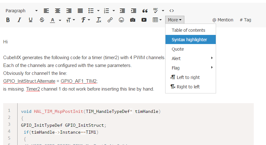

BTW How can one format source code in postings at st.com?
Everything which I tried results in a mess.
There should be a preview option also.
Regards
Dieter
2017-02-07 9:32 AM
Which CubeMx version are you using ? I will check your issue and come back to you as soon as I have needed details.
About
format source code, y
ou should expand toolbar by clicking on [...] icon, then click on ''More >> Syntax Highlighter''.Best Regards
Imen
2017-02-07 2:28 PM
Hi Imen
I'm using the latest CubeMX 4.19
When trying 'Syntax highlighter' the syntax of the text becomes highlighted but ugly formatted or not formatted at all.
Because there is no preview I was wondering whether I should click the send botton.
Regards
Dieter
