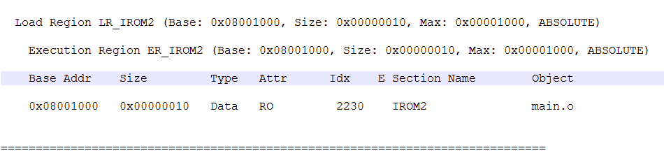

When I check the .MAP file there is LR_IROM2 region created and it reads as follows
Load Region LR_IROM2 (Base: 0x08001000, Size: 0x00002000, Max: 0x00001000, ABSOLUTE)
Execution Region ER_IROM2 (Base: 0x08001000, Size: 0x00002000, Max: 0x00001000, ABSOLUTE)
Base Addr Size Type Attr Idx E Section Name Object
0x08001000 0x00002000 Data RO 2229 .ARM.__AT_0x08001000 main.o
How do I configure a memory region of lesser memory size?

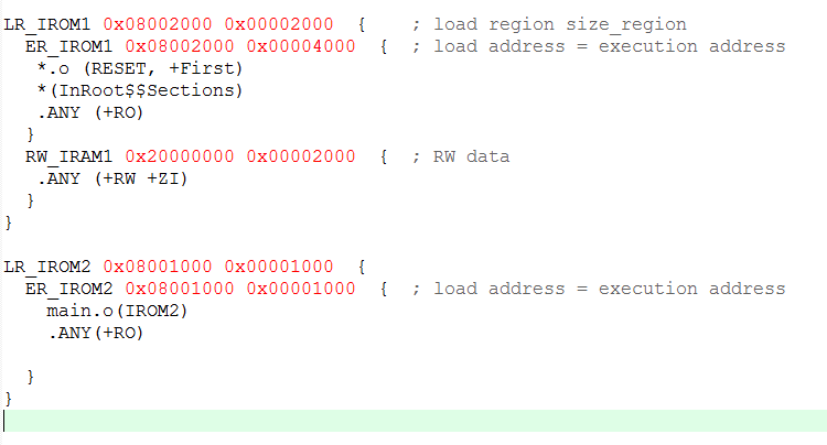

Secondly, eventhough I create ROM2 region in Target settings, why isnt it reflected in the scatter file? When I check the scatter file it shows the following
; *** Scatter-Loading Description File generated by uVision ***
LR_IROM1 0x08002000 0x00008000 { ; load region size_region
ER_IROM1 0x08002000 0x00008000 { ; load address = execution address
*.o (RESET, +First)
*(InRoot$$Sections)
.ANY (+RO)
RW_IRAM1 0x20000000 0x00002000 { ; RW data
.ANY (+RW +ZI)
There is no LR_IROM2 region described here.

Posted on September 29, 2017 at 20:44
Finally,
Had to add --keep=''main.o(IROM2)'' in Options>Linker>Misc controls section
For some reason the linker removes the section. Now I am able to see the data in IROM2.

Posted on September 29, 2017 at 22:16
Yes you are right. I had not made any references. Thank you Clive for your assistance.
Now I can create memory region and allocate the section in scatter file.
But I am still stuck trying to place the header in IROM2.
this is my scatter file and the size of header is only 0x90. And I have specified 0x1000 as the max size. Why is the linker allocating 8kB of data?

Posted on September 29, 2017 at 22:58
Look, I have no idea how larger your header structure actually is, or what's in it. The linker seems to suggest its much larger, or you've consumed more space with other things getting dumped in there. You also seems to have inconsistent sizes for LR_IROM1 and ER_IROM1, and all your code/data headed for IROM1 needs to fit in 8KB which strikes me as rather tight.
You could perhaps drop the .ANY(+RO)
Hard to debug via a key-hole, and screen shots.
