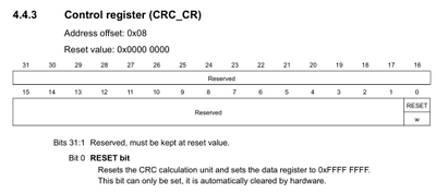

CRC unit is reset by writing CRC_CR.RESET to 1.
If immediately after this data are written into CRC_DR by the processor (i.e. the two writes are in consecutive str instructions), the written data are ignored and CRC_DR reads 0xFFFFFFFF.
Apparently, the guard time promised for DR writes does not apply to this sequence, and the CRC reset takes some time, so that DR writes within a certain number of cycles from CR writes are ignored.
ST, please specify exactly this time.
Thanks,
Jan Waclawek

{Tilen MAJERLE} [Employee] @ {waclawek.jan} on {Feb 8, 2018 2:08 PM}
Hello Jan,
You have to wait for reset bit to go back to 0 before you can start using CRC peripheral again.
{[pastedImage_1.png] -- I don't have this image saved, but I'm pretty sure it was this snapshot from the manual:
waclawekjan_0-1691334986006.png}
Please check last statement.
Best reegards,
Tilen
{waclawek.jan} @ {Tilen MAJERLE} on {Feb 8, 2018 2:13 PM}
Hi Tilen,
Thanks for the explanation. I'll sure try.
However, the last sentence says, that the reset bit is automatically cleared by hardware, not that I have to wait for it to get cleared.
If there is such a claim in the RM, can you please direct me to it.
Thanks,
Jan
{waclawek.jan} @ {Tilen MAJERLE} on {Feb 8, 2018 2:24 PM}
Also, none of the "libraries" appear to do this - they just write the reset bit in CRC->CR and then start to churn in data, without checking whether the reset bit had been cleared.
I looked into Cube/HAL - it's the usual mess I am not willing to delve into, but I could not find any *read* of CRC->CR. Same for Cube/LL. Both from CubeF4 v1.18. Same in 'F4 SPL v1.8
I even went to a very popular site with miscellaneous STM32 libraries and checked there... ;)
Jan
{Tilen MAJERLE} [Employee] {Feb 8, 2018 2:47 PM}
Hello Jan,
none of the examples are writing data just after reset write and that's the reason why the issue was not seen. There are at least 2 cycles of "nothing" before actual write is performed. This is as well something you found in your example that waiting for 2 __NOP works ok.
I agree with you, anyway. RM is confused and I will check this.
