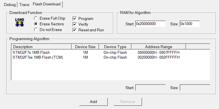

I use Kiel uVision and I try to work with trigonometric functions on a STM32F722ZE (Nucleo board).
I've enabled teh floating point hardware but whenever I use a function from the math.h lib I get the following errors while uploading my code:

Too many errors to display !
Error: Flash Download failed - "Cortex-M7"
What could be the problem?

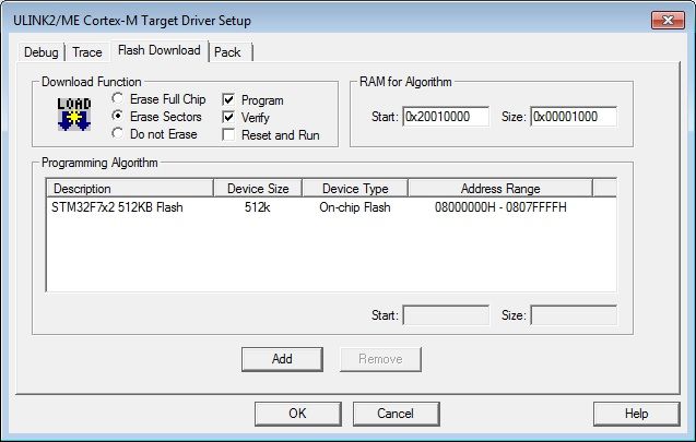

Pretty sure the F722 is architecturally different from the 1MB F7 products, it has 512KB and is banked differently. Different CM7 core, different die. Pick something appropriate to your chosen device. Click ADD and find the right one and delete these ones you show, cause they're not working.
This is what I'd start with...
The wrong flash algorithm is being used, or bank settings are wrong, as code size expands beyond 16KB? Go in via the debug options and review if the flash settings provides for alternative selections.
KMarci
Thank you very much for your help!
The code size has surpassed 16KB and apparently this caused the problem. But why is this a problem? These are my flash download settings:
0690X000006CB6tQAG.pngShouldn't I be able to write more than 16KB memory?
KMarci
Thank you very much for all the help! It solved the problem.
