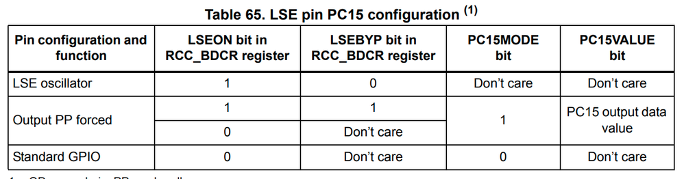

PC15 may have RTC/LSE functionality that needs disabled. Show your code.

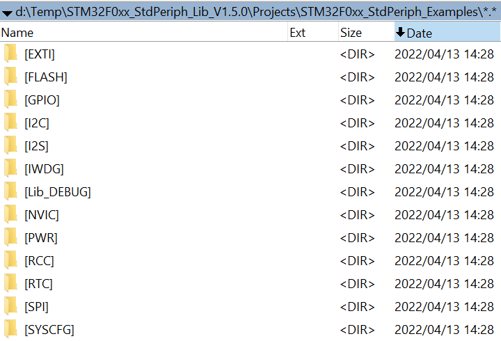

Where is the examples in the SPL (SPI)? In STM32F0xx_StdPeriph_Lib_V1.5.0/../STM32F0xx_StdPeriph_Examples?
0693W00000Lxvx2QAB.pngHere is my code:
RCC_AHBPeriphClockCmd(RCC_AHBPeriph_GPIOC, ENABLE);
PWR_BackupAccessCmd( ENABLE );
RCC_LSEConfig( RCC_LSE_OFF );
GpioDriverInit(GpioC,GpioPin15,GpioInput);
Br,
Tim
waclawek.jan
Why do you think you cannot set the pin? Maybe it's a hardware problem.
You need to enable PWR clock in RCC first.
To test, you can do this all directly in registers in debugger, don't need to write any code.
