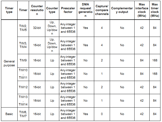

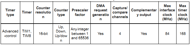

hi everybody
i want to have 8 channel pwm input and 8 channel pwm output in stm32f407vgt6
here is the table of timers in this micro . i also want to have a time scheduling .from your perspective which combination of these times is suitable for 8channel input and which one for 8 channel pwm output and  which one is  good for time scheduling ?
10 REPLIES 10
Posted on August 23, 2014 at 11:58
Doing the due diligence here would seem to take more time than I'm willing to expend, so I'll make some suggestions that might save you some time.
The manual for the board describes the available pins, this is going to limit your options. To do PWM Input mode you are going to need to find EIGHT timers, providing CH1 or CH2 pins. This is likely to be an impossibly high hurdle. Your post provides insufficient detail about the nature/speed of your signalling, so I'll assume it's something slow and mundane like a 50 Hz Servo, and the signals are all very similar in specification so can share a timer. I would suggest using the 32-bit timers to time stamp signal edges using Input Capture mode, where possible.  And use which ever 16-bit timer pins you have available to generate the PWM Output.
Use SysTick for continuous time base requirements, set it to 1 KHz, or whatever the granularity of the requirement is, have it dispatch tasks, decimate, or count off other time related events/signals.

that's right i want to handle 8 50hz servos separately . but why i should use 8 timers for 8 channel input pwm. i mean for example timer2 has 4 channel i can not use each channel for each input ??
Posted on August 23, 2014 at 13:03
Not it PWM Input mode you can't, it uses a pair of channels, and resets the timer. Review manual and examples thereof, and then explain to me how this is going to work. For a one-to-one channel to signal ratio you'd have to be using Input Capture mode.
Are all the servo input guaranteed to be synchronous with each other? Perhaps you can use CH3 and CH4 to latch secondary channels?
