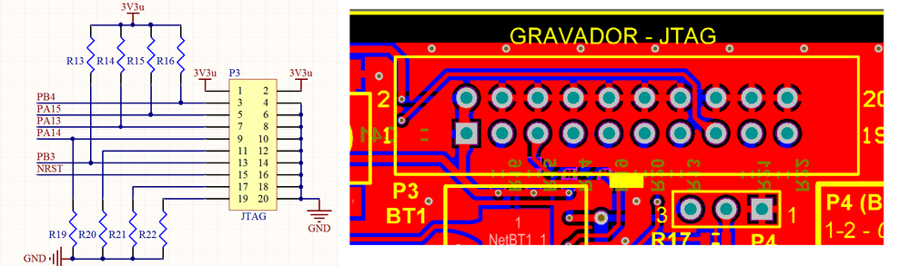

So I have to change another thing like the memory start and size? I tried to program and receive SWD Comunication Error.I dont know if the problem is with my PCB or the program.Thanks for reading.Bye

On your board check your programming header, make sure connectors aren't backward, or pins mirrored, or interleaved incorrectly (ie 1,2,3,4 vs 1,3,5,7). For SWD you minimally need the two SWD pins (SWCLK/SWDIO), GND and NRST, optionally the SWO(JTDO)2013-06-07 9:39 AM
It seems ok to me the header and the pins. The pins numbers are right with the datasheet.2013-06-07 9:55 AM
That doesn't appear objectionable.
