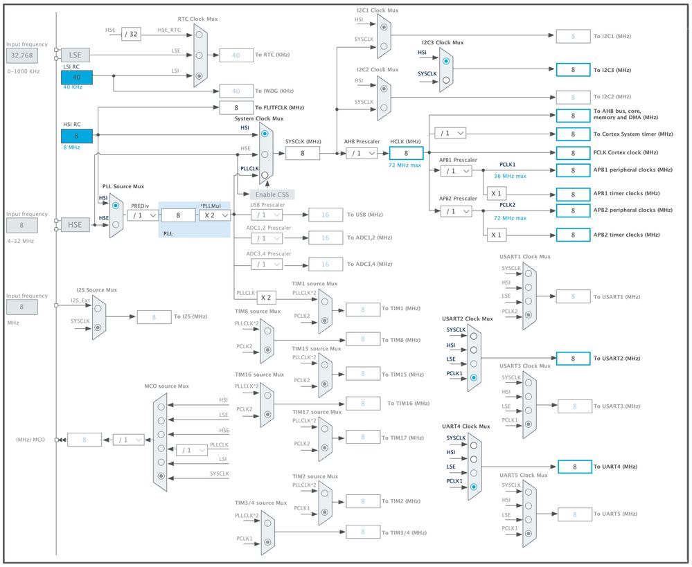

What's the primary clock source? HSI, together with the non-multiple-of-16 of BRR may result in excessive baudrate mismatch.
Thanks for your response. I currently don't have a logic analyzer, but it's clear I will need one.
Clocks are shown attached. I'm fairly new to microcontrollers in general, so the clock setup still is a bit of a mystery to me, though I've been reading to try to understand. I did take a stab at setting up a 115200 baud with MX, and noticed it didn't change the clock setup at all, so I took that to mean it it was ok as-is, but I'm not certain.0693W000000UYXdQAO.jpg
Unfortunately I don't see what can be done without actually measuring the communication from both sides. The module's baudrate may be off, too, at higher rates, I've seen that in the past.
You should use a precise primary clock source (crystal) and a UART (APB) clock such that the fractional part of baudrate divider is 0, both these things increase chances that things will be working.
