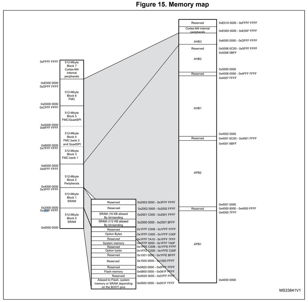

I can't find a proper data sheet for STM32F446RE Nucleo-64 board in which memory maps etc are mentioned. I have downloaded many reference manuals and datasheets, but i cant find it in any of these. The one given on the product page does not have these mentioned.
someone please share one with me if possible..
https://www.st.com/resource/en/datasheet/stm32f446re.pdf
See figure 15, and table 12

man , i was looking for a table in that pdf my bad, thanks..
