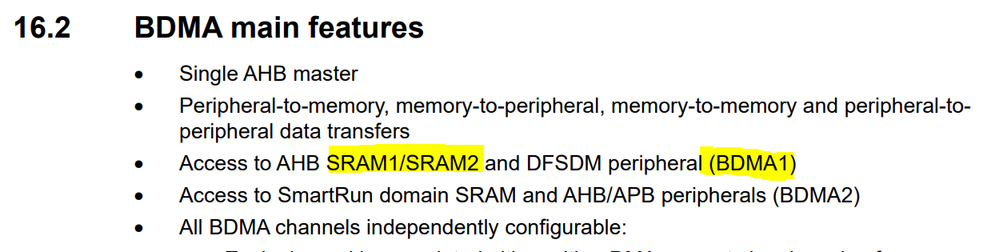

Hello, trying to get DMA transfer to work.
This does work fine:

Yet, this does not work:

What might be the reason for this? What is the fundamental difference between these DMA units (stream vs channel)?
I'm using STM32H7B3 microcontroller. d3buffer is allocated as follows:
uint32_t __attribute__((section (".RAM_D3"))) d3buffer[16]  =
                                      {0};

BDMA1 doesn't have access to SRAM3.
There is some useful information in the reference manual about these peripherals.
A BDMA "channel" is functionally equivalent to a DMA "stream". The latter uses the DMAMUX to map a stream to different request generators. In familites without a DMAMUX, a DMA stream needed to be mapped by selecting one of 8 or so channels.

Thank you! So I need to use the DMAMUX(manually) when using BDMA? I will try that. But if they are equivalent, I might as well stick with the DMA steam which works fine.
