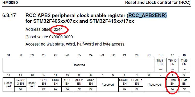

I made a program that still increments the registers, but I also setup timer8 for output compare to make a simple timer.  The output pin I used does not change state.  I used
STM32 ST-LINK utility
to look at the memory contentes around the boundary address of timer 8 and found all the memory in that area is zeros.  I tried to use the utility to change one of the timer 8 registers manually, and it told me ''error occurred during memory writing.''  The flash area of the memory displays correctly.
Am I just unable to interact with the peripheral memory with
am I writing to the peripheral registers improperly?
perhaps the registers for timer 8 are written to but I set them up wrong to strobe an output pin?

Posted on August 06, 2013 at 22:34
You must enable the AHBx and APBx clocks for the peripherals you wish to use.
ie APB2ENR and SYSCFG
LDR R0, =0x40023844 ; RCC_APB2ENR
LDR R1, =0x00004000 ; ENABLE SYSCFG CLOCK
STR R1, [R0, #0]
Posted on August 06, 2013 at 23:06
ldr r0, =0x40023800 ; RCC
ldr r1, =4 ; RCC_AHB1ENR_GPIOCEN
ldr r2, [r0, #0x30] ; RCC_AHB1ENR
orr r2, r1
str r2, [r0, #0x30]
ldr r1, =2 ; RCC_APB2ENR_TIM8EN
ldr r2, [r0, #0x44] ; RCC_APB2ENR
orr r2, r1
str r2, [r0, #0x44]
; OR
ldr r1, [r0, #0x30] ; RCC_AHB1ENR
orr r1, r1, #4 ; RCC_AHB1ENR_GPIOCEN
str r1, [r0, #0x30]
ldr r1, [r0, #0x44] ; RCC_APB2ENR
orr r1, r1, #2 ; RCC_APB2ENR_TIM8EN
str r1, [r0, #0x44]

Posted on August 06, 2013 at 23:19
Thanks for the reply.  I'll try it; however;  I am further confused.  When I look at your assignment for the RCC register, I get the impression you are setting bit 13, which is reserved.  I would expect you want to set bit 1 which is timer 8.  I expect 0x0002.
Is my concept of byte order wrong?
Posted on August 07, 2013 at 00:14
We're talking about the F4, right?
