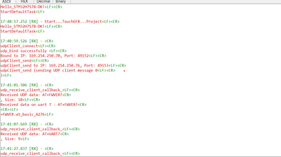

One thing I need to add in this thread,
When I was trying HAL_UART_Receive_IT function and  send cmd from Ethernet, I get response from UART7 but it happens only once(at very first time) then i am not able to get response even after sending same or different cmd.
But when I use HAL_UARTEx_ReceiveToIdle_IT , I am not able to get response even single time.
Here is the screenshot of response i get from UART7 when i send cmd from UART7.
/Mehul

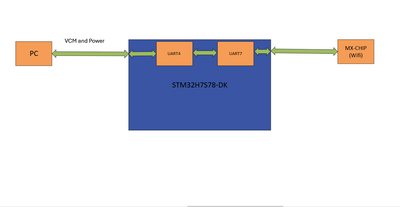

I am using the STM32H7S78 microcontroller and the MXCHIP EMC3080-P WiFi/BLE module.
In my setup:
  1. UART4 and UART7 are enabled on the STM32H7S78.
    • UART4 is dedicated to debugging and is connected to the Virtual COM Port (VCP).
    • I use the Docklight tool on my PC to send commands to UART4.
  2. The flow of data is as follows:
    • A command is sent from the Docklight tool on the PC to UART4.
    • The STM32H7S78 microcontroller receives the command on UART4 via an interrupt.
    • The received command is then forwarded to UART7.
    • The MXCHIP EMC3080-P module, connected to UART7, processes the command and sends a response back to UART7.
    • The STM32H7S78 microcontroller receives the response from UART7 via another interrupt.
    • Finally, the microcontroller sends the received response back to UART4, which prints it on the Docklight tool.
Here I attached rough diagram for understanding.
/Mehul

Hi @Andrew Neil ,
Yes, I have checked the communication using a TTL monitor. When I monitor the TX and RX lines, the communication works perfectly—UART7 successfully sends and receives commands. However, I am not receiving the data through the interrupt as expected.
However, when i comment the UART4 init function and and use Ethernet instead of UART4 to send / receive cmd its work successfully.
But i am not able to see other logs on Docklight as i disabled UART4.
Here is screen shot,
Can you explain this behaviour? Additionally, please suggest how to make it work while keeping UART4 enabled.
/Mehul
