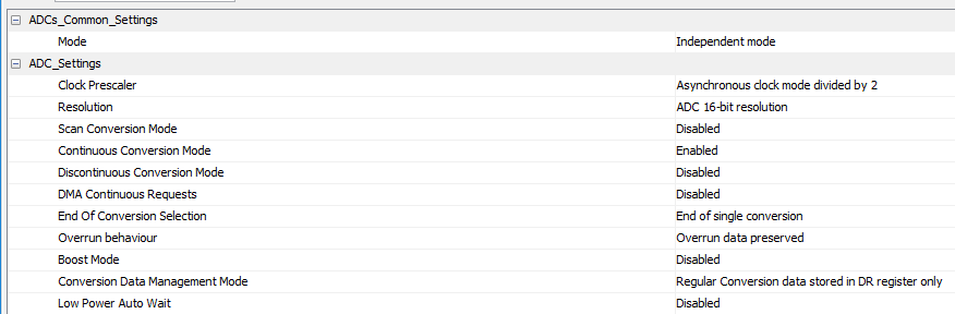

I try to configure ADC + DMA continues cicrcular mode for a H753eval board with CubeMX but with no success.
The example en.stm32cubeh7\STM32Cube_FW_H7_V1.2.0\Projects\STM32H743I_EVAL\Examples\ADC\ADC_DMA_Transfer works perfect but as I have started using cubemx for my other peripherals I would like to stay with cubemx, but I don't get it to work with the ADC+DMA.
Now I have backed to a completely clean project for a 753XI, only configured ADC1_IN0 and RCC(25MHz->400MHz sysclk and 18.75MHz ADC clk).
When I run it as ADC con't mode without DMA
and add the following to my main.c, everything works.

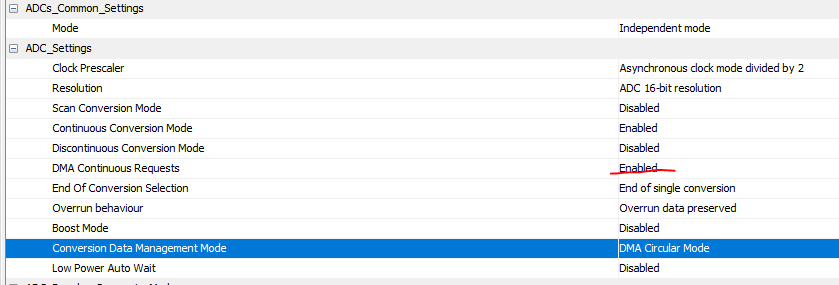

But when I change ADC1 config in cubemx to:
added a DMA1 stream0, with circular mode and changed the rows in my code to:
ALIGN_32BYTES (static uint16_t adcData[32] );
HAL_ADC_Start_DMA(&hadc1,(uint32_t*)adcData,32)
and no code in main()
Nothing works! If a check adc.dr register with the debugger it only takes one value at start-up and nothing more.
I've also fiddled with the Conversion Data Management mode as that parameter is a little unclear to me, circular mode is set in the DMA tab as well and the youtube clips I have seen is using older parts/version which doesn't have that setting.

Solution found: cubemx, at least for H753 and EWARM generates 0x20000000 as default RAM area in the linker file(stm32h753xx_flash.icf) and that is the DTCM-RAM which is not accessible from the standard DMA.
Where is the ICF editor referred to below, I did edit the file for now!
