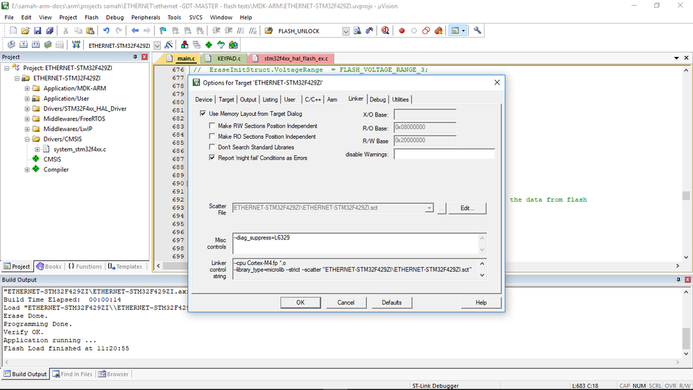

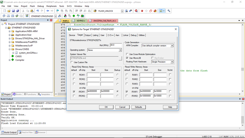

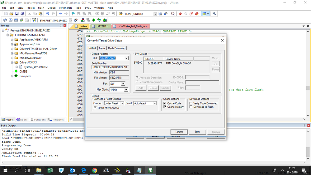

 tell me is this config correct for read and write between sector 0-------->23 stm32f429
Posted on April 20, 2018 at 10:59
does NUCLEo 429 doesnt let any flash writing ??? because it is connected to the small chip stm32f103 to be progammed without stlink???
