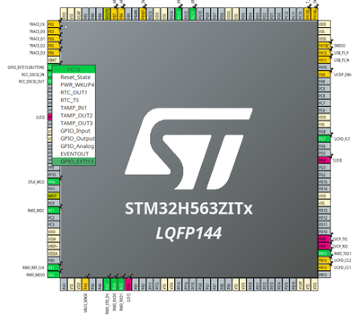

this is what i do to start StopMode (this code is the NetxDuo thread function):
static VOID nx_app_thread_entry (ULONG thread_input)
  /* USER CODE BEGIN Nx_App_Thread_Entry 0 */
    HAL_SuspendTick();
    HAL_PWR_EnterSTOPMode(PWR_LOWPOWERREGULATOR_ON, PWR_STOPENTRY_WFI);
  /* USER CODE END Nx_App_Thread_Entry 0 */
}and this is how i setup the controller:
I tried what's shown in the figure, i was expecting the execution to continue after pressing the button. If it worked i would have start to work on the Ethernet wake up.
if more information are needed i will provide them as soon as i can.
Solved! Go to Solution.

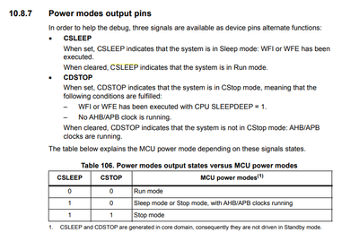

another Tips in trying to visualize the signals CSLEEP and CSTOP pins to know the state of your device and if it really entered a stop mode.
here is the snippet describing the state of this pins from STM32H523/33xx, STM32H562/63xx, and STM32H573xx Arm<Sup>®</Sup>-based 32-bit MCUs - Reference manual
