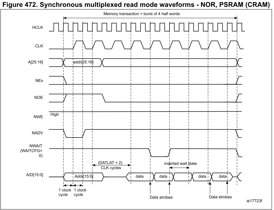

I want to use FSMC to read external FIFO implemented in an FPGA. Since there is no mode of FSMC that can match FIFO interface exactly, so I want to use the modified synchronous multiplexed PSRAM mode.
The plan is like this
A[25:16]: Ignored, don't connect to FIFO;
NEx, NOE, NADV: Implement a simple logic in FPGA that when NEx is valid and the NADV is data valid, connect the inverted NOE to the RD port of FIFO;
NWE: ignored, only read operation is needed;
D[15:0] : Connect to the output data port of FIFO;
There may be also some logic in FPGA to adjust the timing between NOE and D[15:0], but that is not a big problem.
What I want to ask is
  1. Is this plan feasible? What should I take care of when implement it?
  2. How can I extend the data burst length as long as possbile? Since there are 2048x16bit in one frame, I want to read them all in one burst if possible.

It's hard to say without knowing about the FIFO signals and their timing requirements.
